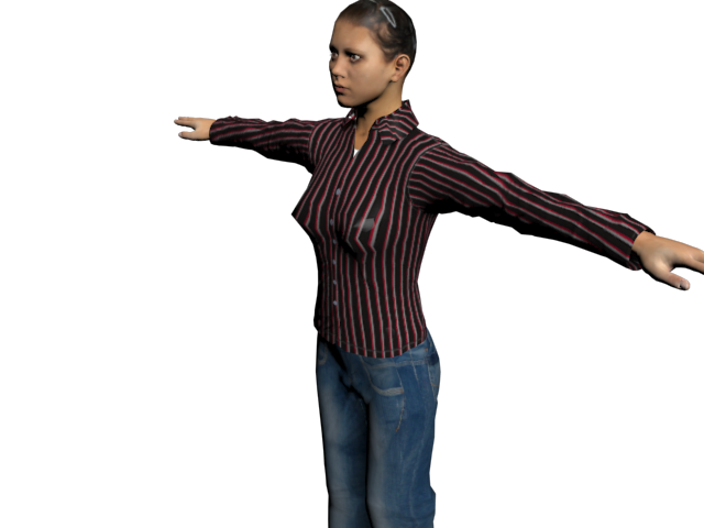

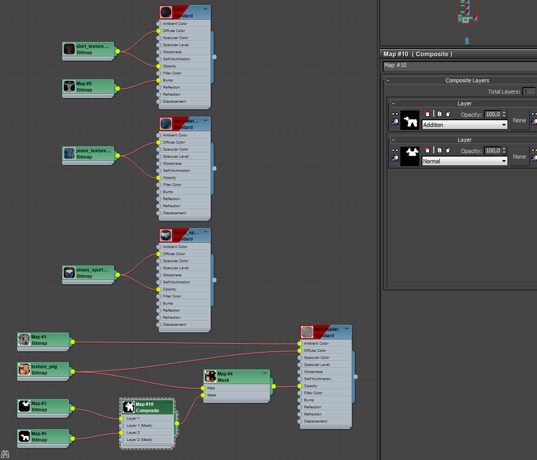

Postby dark poulpo » Mon Jan 21, 2013 6:15 pm
i have a soluce... i use 3dsmax... but i think than the method is the same for all.
0) export to dae
1) export makehuman -> .mhx
2) import to blender and export to dae with all textures (add the mask files) (blender crash but the texture files are already exported)
3) import dae (step 0) in 3dsmax and add the mask files in the materials editor.
if the makehuman could make the same effect and export all files (include masks files), it'll cool!
and.. tada!!!
4) i have juste a bug (reflect) (see the screenhoot)
bug
