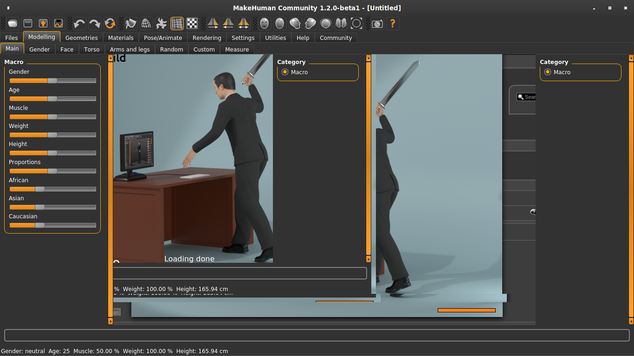

Hi, I'm still new to reporting bugs so I don't want to mess up an end up being more trouble.
The issue is that, for some reason the viewport is stuck with the previous image displayed. Even after the splash screen or any of the other tabs it still displays whatever was on the viewport area.
However, it does show correctly for a milisecond once I click the close window.
Happens with the PPA version and the running from source version, this last one works fine if I use the --noshaders option from the terminal, which is a bit tedious.
I'm using Ubuntu 20.04 LTS. Screenshot in case I wasn't clear.

Don't worry, we obviously want reports of makehuman not working as intended. Some questions though:
Which graphics card are you using?
Do you get any error information in the logs? (See http://www.makehumancommunity.org/wiki/ ... _report%3F)

I'm using an Acer Aspire laptop model F5-571T-569T, it has an integrated Intel HD Graphics 4400 with up to 4184 MB Dynamic Video Memory. The CPU is Intel Core i5-4210U.
This is what the logs on the program return

Assigning setting Scene_Editor_FileDlgPath value /home/moss/Documentos/makehuman/v1py3/data/scenes that was loaded before the setting was declared.
Loaded plugin 7_scene_editor
Importing plugin 7_scripting
Imported plugin 7_scripting
Loading plugin 7_scripting
Loaded plugin 7_scripting
Importing plugin 7_shell
Imported plugin 7_shell
Loading plugin 7_shell
Loaded plugin 7_shell
Importing plugin 7_targets
Imported plugin 7_targets
Loading plugin 7_targets
Loaded plugin 7_targets
Importing plugin 8_asset_downloader
Imported plugin 8_asset_downloader
Loading plugin 8_asset_downloader
Loaded plugin 8_asset_downloader
Importing plugin 9_export_bvh
Imported plugin 9_export_bvh
Loading plugin 9_export_bvh
Loaded plugin 9_export_bvh
Importing plugin 9_export_collada
Imported plugin 9_export_collada
Loading plugin 9_export_collada
Loaded plugin 9_export_collada
Importing plugin 9_export_fbx
Imported plugin 9_export_fbx
Loading plugin 9_export_fbx
Loaded plugin 9_export_fbx
Importing plugin 9_export_light
Imported plugin 9_export_light
Loading plugin 9_export_light
Loaded plugin 9_export_light
Importing plugin 9_export_obj
Imported plugin 9_export_obj
Loading plugin 9_export_obj
Loaded plugin 9_export_obj
Importing plugin 9_export_ogre
Imported plugin 9_export_ogre
Loading plugin 9_export_ogre
Loaded plugin 9_export_ogre
Importing plugin 9_export_stl
Imported plugin 9_export_stl
Loading plugin 9_export_stl
Loaded plugin 9_export_stl
Importing plugin 9_export_uvmap
Imported plugin 9_export_uvmap
Loading plugin 9_export_uvmap
Loaded plugin 9_export_uvmap
Loading GUI
showing category Modelling
showing task Macro modelling
Loading theme
Theme makehuman version 1.2.0
Loaded theme data/themes/makehuman.mht
Loaded Qt style data/themes/makehuman.qss
Applying targets
no compressed targets found
compiled file missing: /home/moss/makehuman-devel/makehuman/makehuman/data/targets/macrodetails/african-female-young.target
compiled file missing: /home/moss/makehuman-devel/makehuman/makehuman/data/targets/macrodetails/african-male-young.target
compiled file missing: /home/moss/makehuman-devel/makehuman/makehuman/data/targets/macrodetails/asian-female-young.target
compiled file missing: /home/moss/makehuman-devel/makehuman/makehuman/data/targets/macrodetails/asian-male-young.target
compiled file missing: /home/moss/makehuman-devel/makehuman/makehuman/data/targets/macrodetails/caucasian-female-young.target
compiled file missing: /home/moss/makehuman-devel/makehuman/makehuman/data/targets/macrodetails/caucasian-male-young.target
compiled file missing: /home/moss/makehuman-devel/makehuman/makehuman/data/targets/macrodetails/universal-female-young-averagemuscle-averageweight.target
compiled file missing: /home/moss/makehuman-devel/makehuman/makehuman/data/targets/macrodetails/universal-male-young-averagemuscle-averageweight.target
Updating skeleton joint positions
Done baking animations
Loading macro targets
Loading done
Creating new texture for dynamic image data/litspheres/adaptive_skin_tone.png.
initTexture: 256, 256, False
Creating new texture for image /home/moss/makehuman-devel/makehuman/makehuman/data/eyes/materials/brown_eye.png.
initTexture: 1024, 1024, False
Creating new texture for image /home/moss/makehuman-devel/makehuman/makehuman/data/litspheres/skinmat_eye.png.
hiding category Modelling
showing category Utilities
hiding task Macro modelling
showing task Data
hiding task Data
showing task Logs

Postby Nemerd » Sun Jul 12, 2020 4:26 am
MakeHuman version: The GitHub repository as indicated on the documentation. The terminal sends me this:
VERSION: master:dc079434
SHORT VERSION: beta2
LONG VERSION: 1.2.0 beta2 (master:dc079434)
OS: Ubuntu 20.04 focal
Graphics card: The console sends me this:
GL.VENDOR: Intel Open Source Technology Center
GL.RENDERER: Mesa DRI Intel(R) HD Graphics 4400 (HSW GT2)
GL.VERSION: 3.0 Mesa 20.0.8
which is accurate, an "Intel HD Graphics 4400, up to 4184 MB Dynamic Video Memory" as advertised on the sticker.
It might also be cool if from the program we could choose if at the next start we want the --noshaders applied so that we don't need to run it every time from the console to make this explicit, thus making it more user-friendly.
Nemerd
Posts: 3
Joined: Sun Jun 28, 2020 4:35 am
Re: Viewport not showing until closing linux
Postby punkduck » Sun Jul 12, 2020 8:31 am
hmm, you can simply change the starter in Ubuntu ...
I am still working with a Ubuntu 18.04 but I guess that is not different. Using xfce4 on my box I do a left mouse-click on the icon, then a menu appears where I can change the starter. Change "/usr/bin/makehuman" to the command you need.
For other managers there are also methods provided, I still remember kde etc. It works, otherwise it would be impossible to start own programs with a starter.
Posts: 903
Postby Aranuvir » Sun Jul 12, 2020 11:45 am
There was a discussion to embed the --noshader option in the settings tab. The only question is is if you will ever get there, or will the application crash before.
About the original bug: IIRC, Intel has changed the driver support in regard of legacy OpenGL for older Intel processors. That's why it might work with Ubuntu 18.04, but not with a newer version of the OS.
In case my memory is correct here, there are basically three possible fixes (which probably will disappoint you): 1) Wait until the render part of MH got rewritten (what is equivalent to "will probably never happen"...) 2) Downgrade your OS and see if it works (trying a virtual machine could also be an, and most likely be the best option, though the OpenGL support in VirtualBox on the other hand is not the best). 3) Get a new computer.
Posts: 1172
