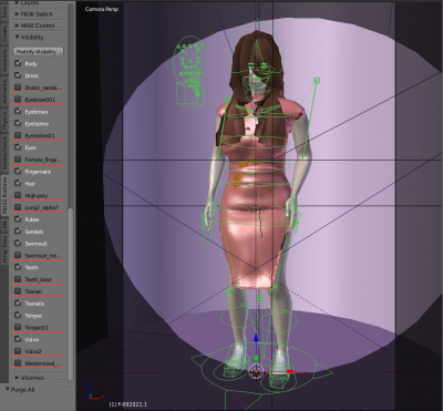

The problem comes when, after I'm done fixing everything up the way I want it to be, I reinstate the "Visibility" panel and all my characters clothes show up with their new names but the old names are still there.
Screenshot:
In this example, the items underlined in red have been renamed:
"Dudoc_sanda..." > "Sandals"
"Eyebrow001" > "Eyebrows"
"Eyelashes01" > "Eyelashes"
"Female_finge..." > "Fingernails"
"High-poly" > "Eyes"
"Long2_alpha7" > "Hair"
"Swimsuit_res..." > "Swimsuit"
"Teeth_base" > "Teeth"
"Toenail" > "Toenails"
"Tongue01" > "Tongue"
"Vulva2" > "Vulva"
"Westernized..." > "Dress"
As you can see, all of the original item names are still there. They do not work when you click on the check box. Nothing happens except the check mark appears/disappears.
I have tried several methods to "kill" orphans like I have done in other areas of Blender but those orphaned names STILL appear and I don't know how to get rid of them.
So, the question is... How do I get rid of these orphaned items?
