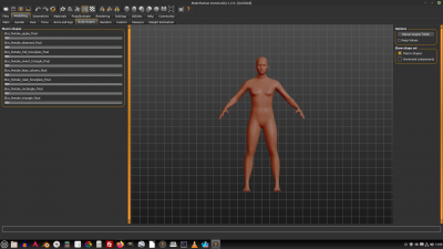

I am using MH v1.2.0 running on Linux Mint Cinnamon 20.2 Uma. I downloaded all the body shape resources from your github page at the link that you have provided and then put them in the right places within the correct folders inside MH. They all show up as though all is well.
The plugin which calls them is active and the sliders are there under the tab specified. However, when a slider is moved, nothing happens to the model, which is the default base that loads when MH starts.
Body Shape Plugin For MH by Joe Paul
Screenshot of MH v1.2.0 on Spanky

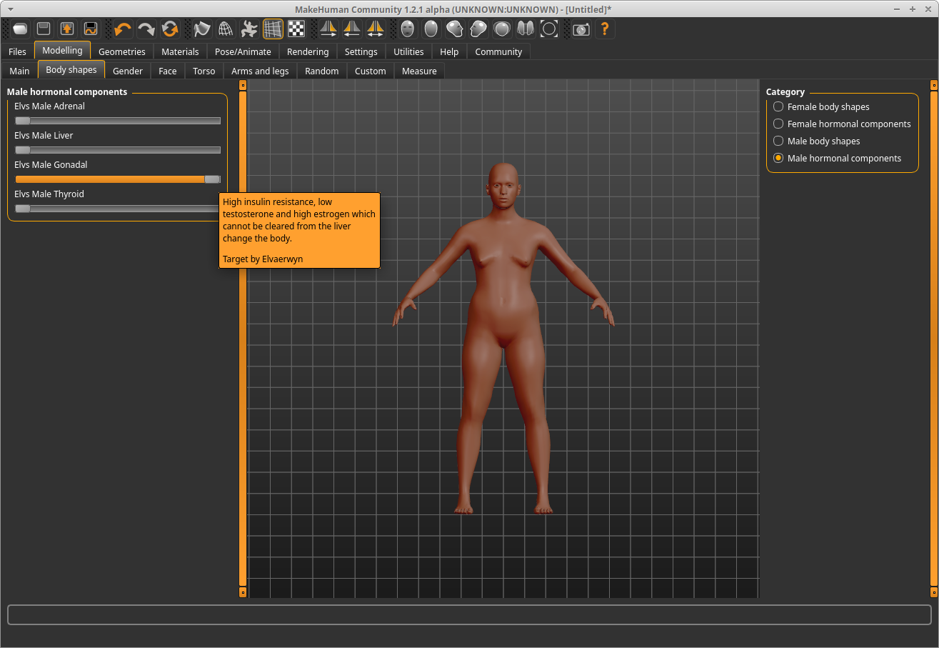

Well I had a similar problem, because the "female" was cut out and the system tried to handle it as a macro-target. To see what is happening, you should look in the log file. In my case it complained that the target was missing.
However: Elvs targets will be fully integrated in next MakeHuman 1.2.1, because MakeHuman then offers body shapes (we already have head shapes, so body shapes were a good enhancement).
... There are some targets which she still wants to improve but a lot is already working ... it is still an unmerged branch, of course it is possible to check it out, compile the targets and replace makehuman ... but be careful I also changed some stuff to get tool tips etc. ... I would not recommend this without the knowledge how the software works. Nevertheless here is the path.
https://github.com/makehumancommunity/makehuman/tree/bodyshapes
we also try to add some information to make it more professional, this is, what it looks like today ..
the slider names will be changed, I guess and maybe some other things as well. But in the end it will be pretty seamless and fits 100% to the rest. This extra-plugin will disappear, when it is fully integrated,

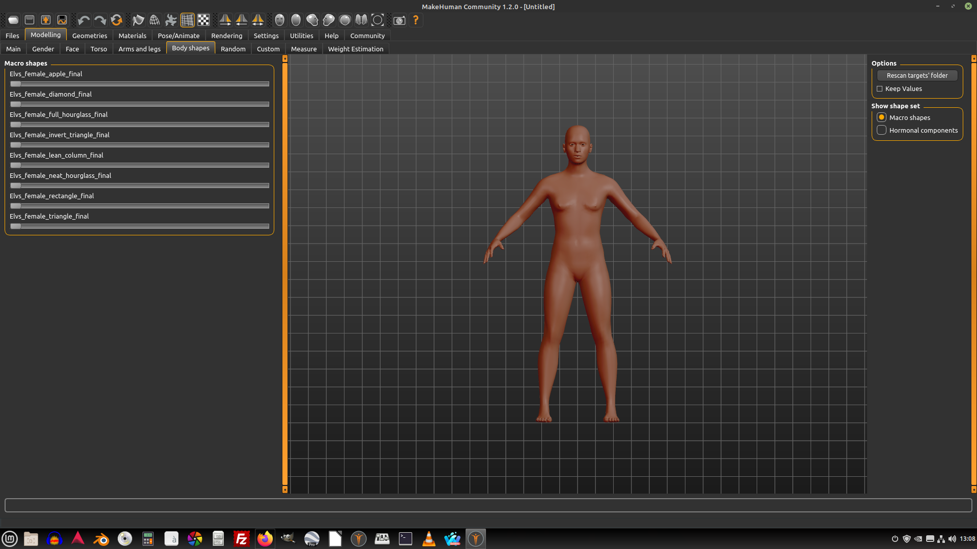

Greetings, folks.
I got the body shapes plugin to work. I had to check and correct the names of the target files and edit the python file. The file had the wrong text inside, being a bunch of HTML stuff that I had to remove to make the file blank after which I went to Joe's github link to retrieve his script, which I copied and pasted into the local file.
The reason the original trial failed, referred to and shown in the screen shot in the post above this one, was due to targets being improperly downloaded from github, showing up containing HTML rather than the script python recognizes. I unzipped Elv's final versions from the threads and private notes here at the community and put them in the proper share folder. Voila! It worked.
In summery, I used Joe's original python file and Elv's final target files and all worked in MH v1.2.0 the way it should. To do this on your own box, put the plugin inside your home/../plugins folder and the targets inside your share/../data/targets/bodyshapes folder (you will need to create the bodyshapes folder since it is not there by default.)

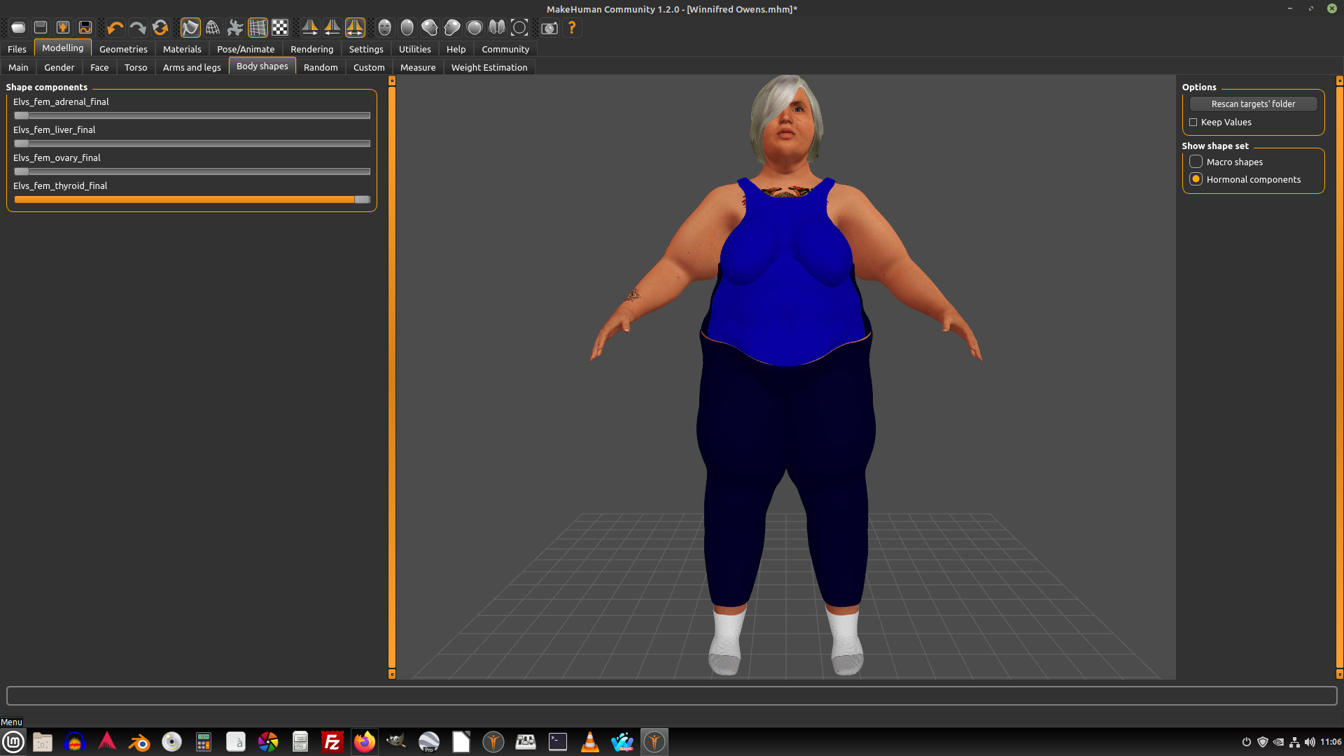

Winnifred Owens, yoga student
Mount Olympus City, Mars
Above, we see a screenshot of MH v1.2.0 with an SSBBW model by the name of Winnifred Owens loaded. This model started out from the default base and has the thyroid shape at 100% along with several tweaks using the complete BBW target set by Elv and some standard sliders native to the program. The body shapes tab is using the python script by Joe.
We are working on installing and testing a second version of this plugin which will use the github resources made by Punkduck. This second version he has made includes targets for male and female body types along with some improvements to the plugin interface and controls. Since the second version relies on JSON files called from the python file, it will be a bit more of a challenge to get up and running.
