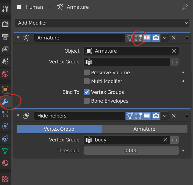

Postby joepal » Mon Sep 20, 2021 11:53 am
This is because your rig modifier is disabled for edit mode. Enable it and you should see the modification in edit mode too:
