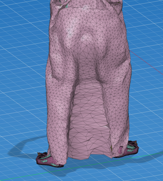

first time posting here, right now i am trying to crate a human with a dress on.
unfortunately it clings onto the legs too much so it looks very odd.
is there any easy solutions or fixes i can look into? or should i try and modify these clothes on my own?
thanks in advance! :D

Postby RobBaer » Wed Nov 13, 2024 4:15 pm
My quick guess is that you fit it to the human instead of the helpers. Try fitting the dress to the helpers instead.

Re: dress clinging on
Postby myrlejon » Tue Nov 19, 2024 1:08 pm
RobBaer wrote:My quick guess is that you fit it to the human instead of the helpers. Try fitting the dress to the helpers instead.
i think that is what i do right now. how do i fit it to the helpers? i searched around but found nothing :cry:
Postby joepal » Thu Nov 21, 2024 8:27 am
You do this by assigning vertex groups on the clothes to use names of vertex groups which are present on the human. On the clothes, the vertex group should probably be set to "helper-skirt" rather than "body".
To see the helpers on the human, toggle the mask modifier on the body.
