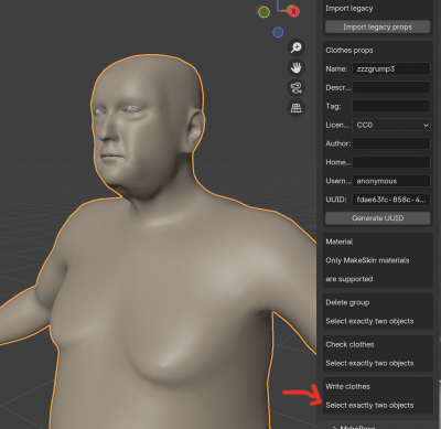

Just to see, I tried this again using the latest MPFB Blender Add-on
(found here: https://extensions.blender.org/add-ons/mpfb/)
For some reason it insists that I select "exactly two objects" before I can create the clothes? Why tho?
I'm so confused, thanks for any clues

Postby joepal » Wed Feb 05, 2025 6:27 am
Clothes consists of two parts:
- The vertices of the clothes mesh
- Information about how they should be matched against the base mesh
In order to caculate the matching, you need both the clothes and base mesh. So these two objects need to be selected when performing the operation.
Posts: 4616
