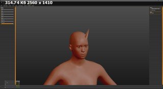

jjones wrote:Decided to try again with Blender 4.3, had a little more luck, but an asymetrical result
I don't get it, you almost got it right this time. You just had to apply a modifier.

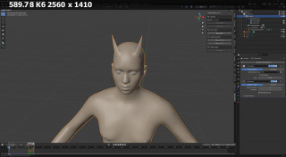

When using maketarget2 and the command “Copy -x to +x”
the following result is obtained:
In MH, it appears the part that was copied, but not the source part.
and I'm not sure if this is the correct behavior.

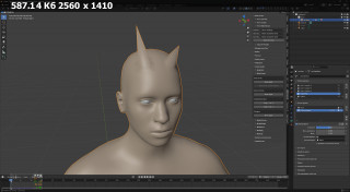

Re: MakeTarget questions
Postby tomcat » Thu Feb 06, 2025 3:43 am
The behavior does not change if left “PrimaryTarget”.
But what is curious is this. If using "Symmetry", the duplicated part will react to the change of the form key value. While the original one will not change. And it is this part that is correctly displayed as a target in MH.
Posts: 477

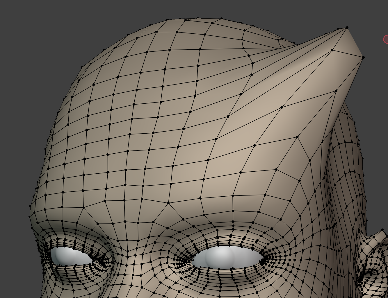

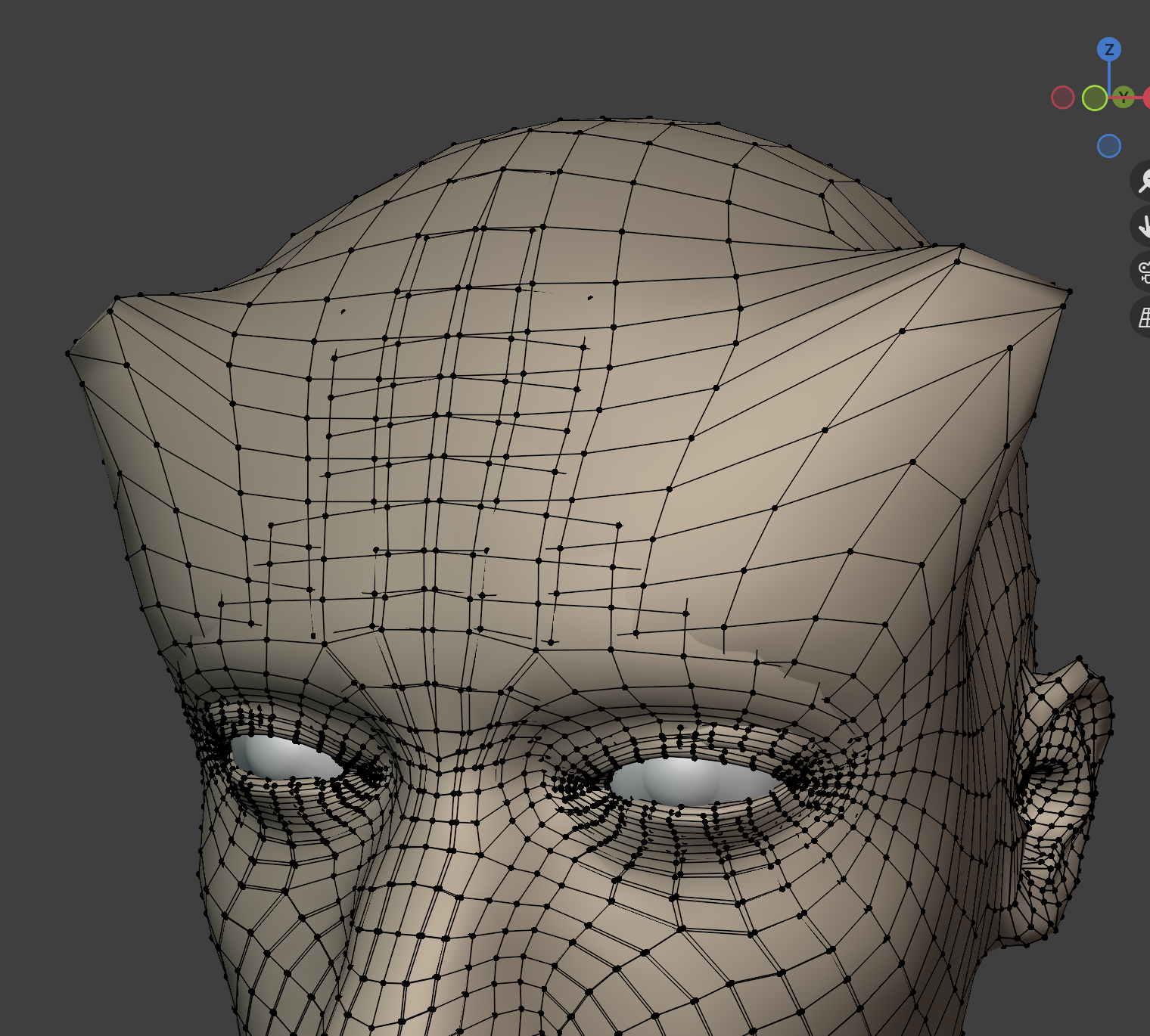

Postby jjones » Sat Feb 08, 2025 6:39 pm
Maybe this is part of the problem?
I notice, in Blender, after I hit Mirror modifier -> Apply and then go to Edit mode, the quads look pretty messed up.
If I just use sculpting tools without the Mirror modifier, the quads look ok
But then the target turns out blank for some reason.
Postby tomcat » Sat Feb 08, 2025 8:07 pm
jjones wrote:I notice, in Blender, after I hit Mirror modifier -> Apply and then go to Edit mode, the quads look pretty messed up.
It's not “messed up quads”, the whole modified grid is duplicated and mirrored. Well, that's how this modifier works.
Postby jjones » Sat Feb 08, 2025 8:59 pm
Well, I think it would be 'messed up' from the perspective of MakeHuman, afaict. I'm sorry if you don't like my choice of words.
