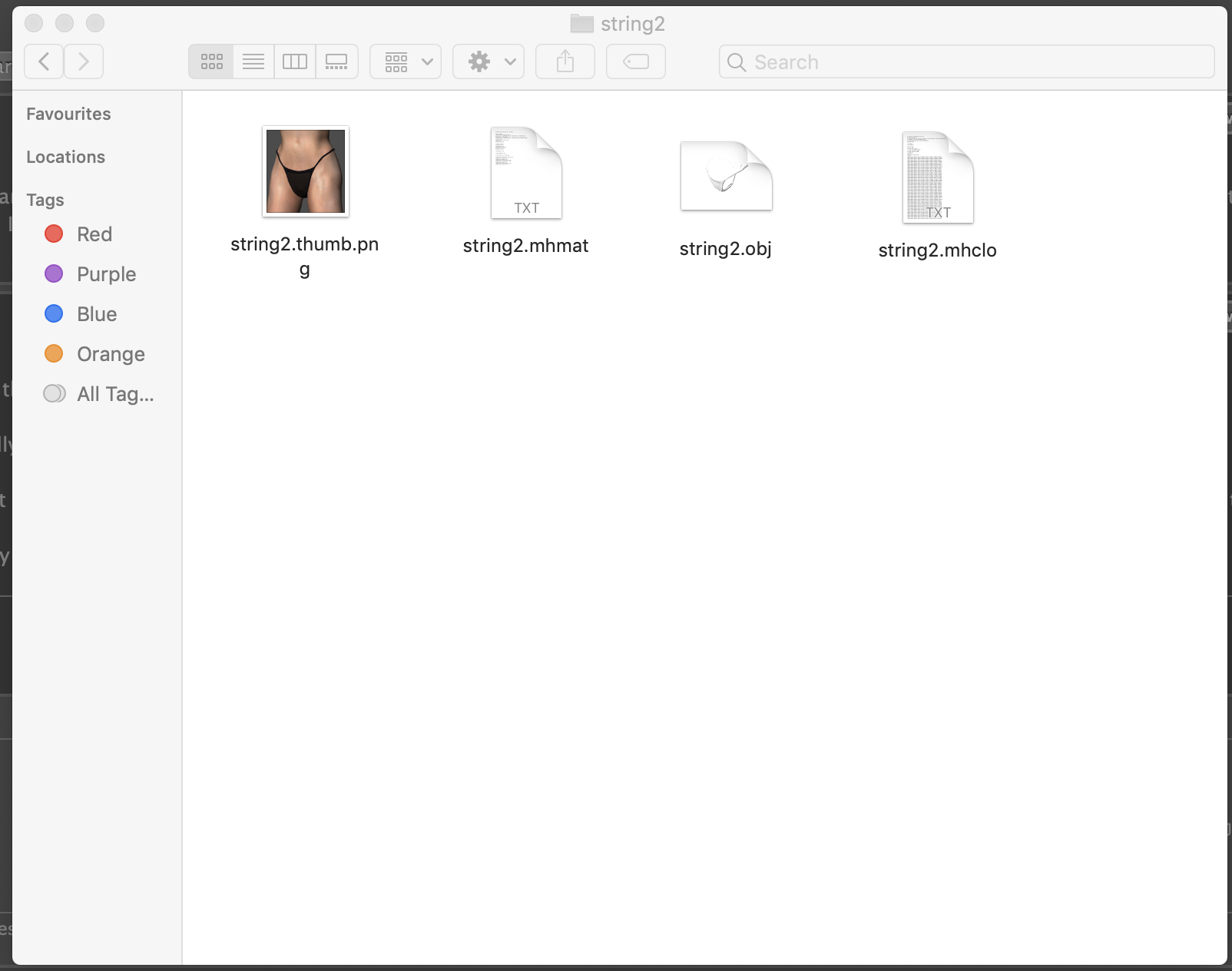

I installed a 3rd party geometries (full-beard) under the Hair directory and (string2) under the Clothes directory as per the FAQ instruction but can't find them in Geometries to use them. Is there something more to do. I use a Mac and it adds a .txt extension automatically, which I deleted but otherwise I see no issues.

For a clothes (hair/bodypart) type of asset you will need one file with the extension .mhclo, one .mhmat and one .obj. You will most likely also need one or more image type files.
Can you post a screenshot of the directory where you placed these files?

Screenshots attached.

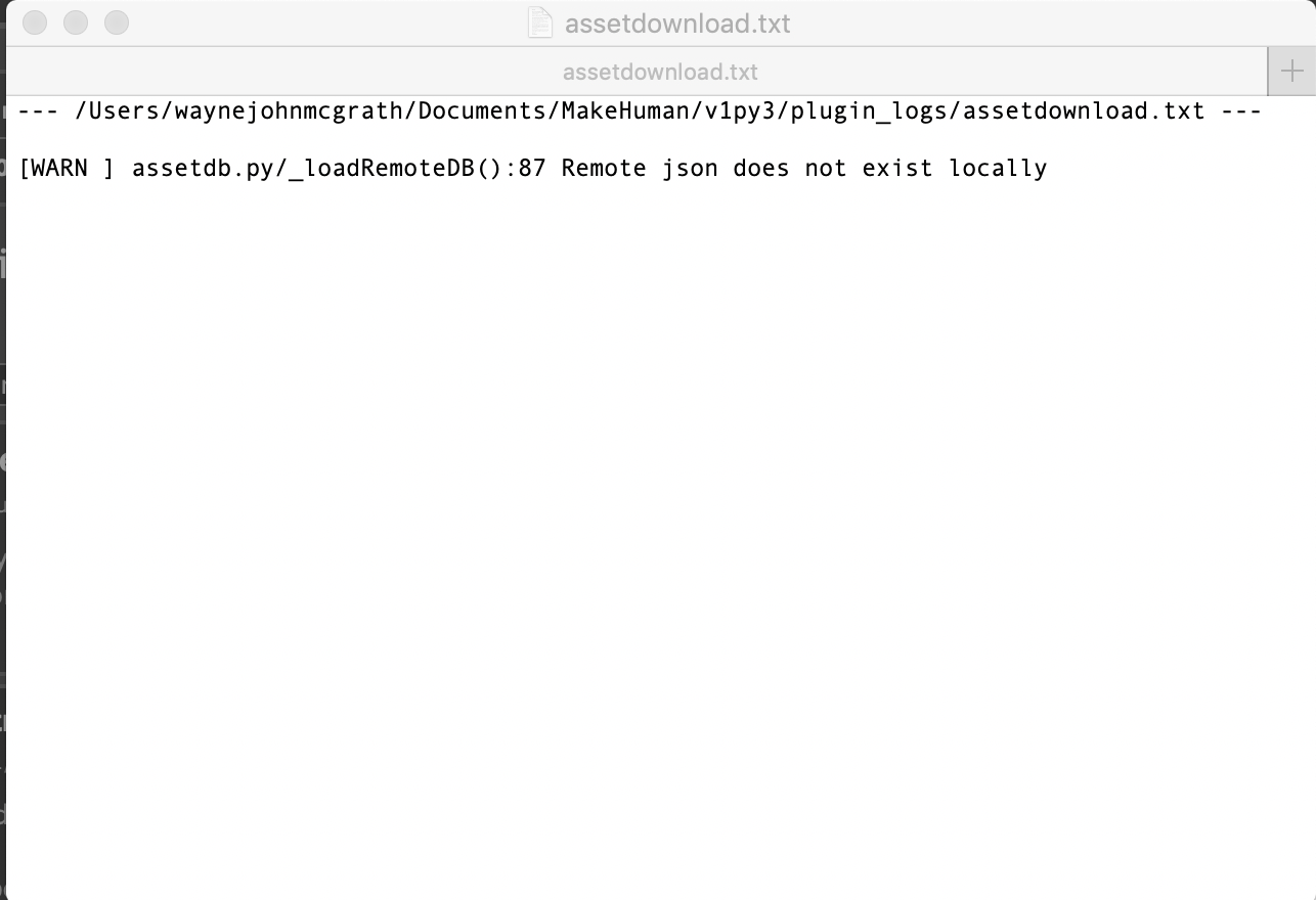

Also, I installed the 1_mhapi plugin and the 8_asset_downloader in the plugins folder. There was no log for the 1_mhapi and the 8_ asset_down_loader log showed a dependancy error (also attached).

As the icons in your screen capture shows, the mhmat and mhclo files are still text files.
Removing the string ".txt" from the end of the file name does not change this in the Mac OS.
Open up the "Get Info" window on these files, and in the "Name & Extension" section, change the extension to the correct value.
The Mac OS should ask if you really want to make the change, this is a good indication that you have done it correctly.
