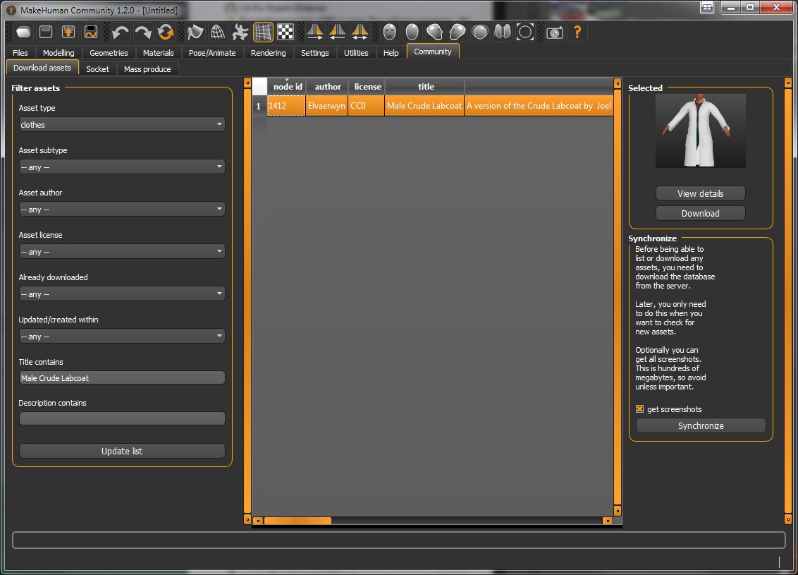

There is another way. You can use "Download assets" in MakeHuman. Then the clothes will be installed automatically.
Download assets
