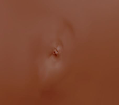

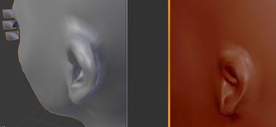

I've just spent most of the day trying to figure out what I'm doing wrong. After going over the documentation 5 times I must admit defeat and ask for help. The left shows the no ear target in Blender. The right is the same no ears applied as a custom target.
What's wrong?
I used smooth vertex and sculpting in order to achieve the result. According to the help file:
To create a custom target, the artist has to alter the base mesh, which is done in the usual way within Blender. First start edit mode, and then select one or more vertices, moving them to reshape the mesh. You may use the full power of Blender to create your morphing target design. The only rule, in order to create a valid morphing target, is to never add or delete a vertex, face or edge. The topology must be absolutely preserved. After the modelling process is completed, the MakeHuman™ morphing target can be saved by pressing the "Save Target As" button on the MakeTarget™ panel. By default this will save all of the offset deviations of every vertice from the base mesh into the target file.
The "full power of blender" statement suggests that I can sculpt, without adding anything to the mesh, so I did that. I simply sculpted the model without messing with any type of modifiers. Is that what I did wrong? I thought that perhaps all the modeling was done by sculpting on the mesh. Am I missing a step? please tell me what I did wrong so I can really help you guys make non standard characters by sharing my ideas as I complete them.

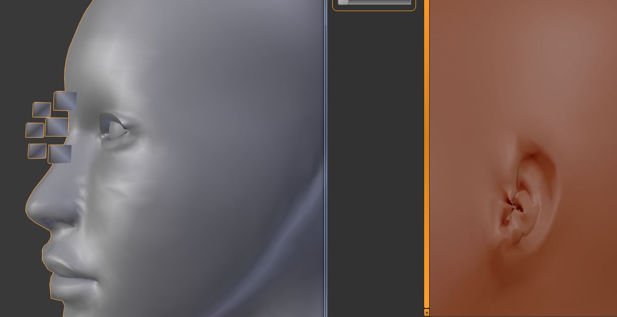

Edit: ah! I think you were right. I set the female as base and loaded the mesh and got the same effect. Going to make it on that after I discard it and try again
Not Quite as bad
It's not that bad but I think I know the problem, sculpting mode, because I messed around out of sculpt mode to try and smooth it better before dipping into sculpt mode
Edit: Even without touching sculpt mode I it looks the same with the basic base mesh. is it something with smoothing?
Edit:If I mess around with the actual vert locations by moving them then it works flawlessly. I think you might have a smoothing issue, which is an issue in itself because smoothing is a major part of my work flow. It's an easy way to lessen angles without wasting time with moving them around until they look smooth.
Progress!
Edit: however, if I sculpt smooth it then it looks the way it should look. I can work with that. it's awkward, cause I work best in vert edit mode but it's a good way to practice I guess. However I would love to be able to use smooth vertex and simply chose how many iterations to do. That in itself is a major time saver.

Postby duststorm » Mon May 05, 2014 11:40 pm
It has nothing to do with scultping.
InsaneXade wrote:I am using the raw base mesh, since I plan on using it for all types of characters.
This reasoning is incorrect. What you are doing doesn't work (well) because you misunderstand how targets work in MakeHuman. To do what you want to do: perform a detailed absolute correction to completely flatten out certain details you need very fine grained control over all macro variations of these details, to be able to negate them.
To make it work with all characters, you need to remodel it for all characters. It's as simple as that, that's the only way to make this work.
This means you have to create variations of your target for about 3*2*4* (race*gender*age) == 24 variables. That's 24 different targets to create.
You might perhaps be able to cut some corners by strategically choosing the variables to model for, with imperfect but acceptible results, but it's far from ideal.
As I said, it would be way easier to just create an alternative topology, which would in fact work perfectly for all characters. As an added bones, you can clean up the topology, simplifying and saving all the polygons that are not needed when ears are gone.

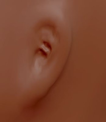

Well, I thought I would do one last try before admitting defeat. I used the sculpting to smooth the ear out. it looks fine in Blender but not so nice in make human. guess whenever I get that far I'll just do it to each model as required. However, it makes me wonder if elf ears, which only require moving and stretching the outer ear, would be possible in makehuman. It seems to me that's the section of ear that has the square in it, which prevents an open matrix.

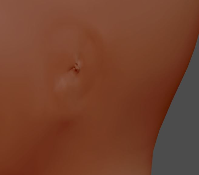

Upon experimenting with the ear related targets in MH I find that the basic ear shape is actually preserved and that is why it warps the no ear target. I moved the ear size slider and got this result
Big ear
So, is this a bug? Or is it just the way MH does the ear targets and I was meowing at the wrong bird to begin with?
How would I make a no ear mesh and an elf ear mesh?

Postby duststorm » Thu May 08, 2014 12:48 pm
InsaneXade wrote:it makes me wonder if elf ears, which only require moving and stretching the outer ear, would be possible in makehuman.
Of course it works. As I have been trying to tell you: you're misunderstanding fundamental concepts.
If you want to create anti-targets, which is what you're trying to do, you need an 100% absolutely exact negative version of the target stack, which means you carefully need to create targets for all targets that mh applies.
This is completely different from adding targets as relative offsets (like pointy ears), which will work much better with even just one target.
InsaneXade wrote:So, is this a bug?
No, you're just doing it wrong, the behaviour is 100% expected.
InsaneXade wrote:How would I make a no ear mesh and an elf ear mesh?
Same approach as you did before with sculting would work, just use makeClothes, not makeTarget, as already explained in this thread.
For elf ears you can use targets.
