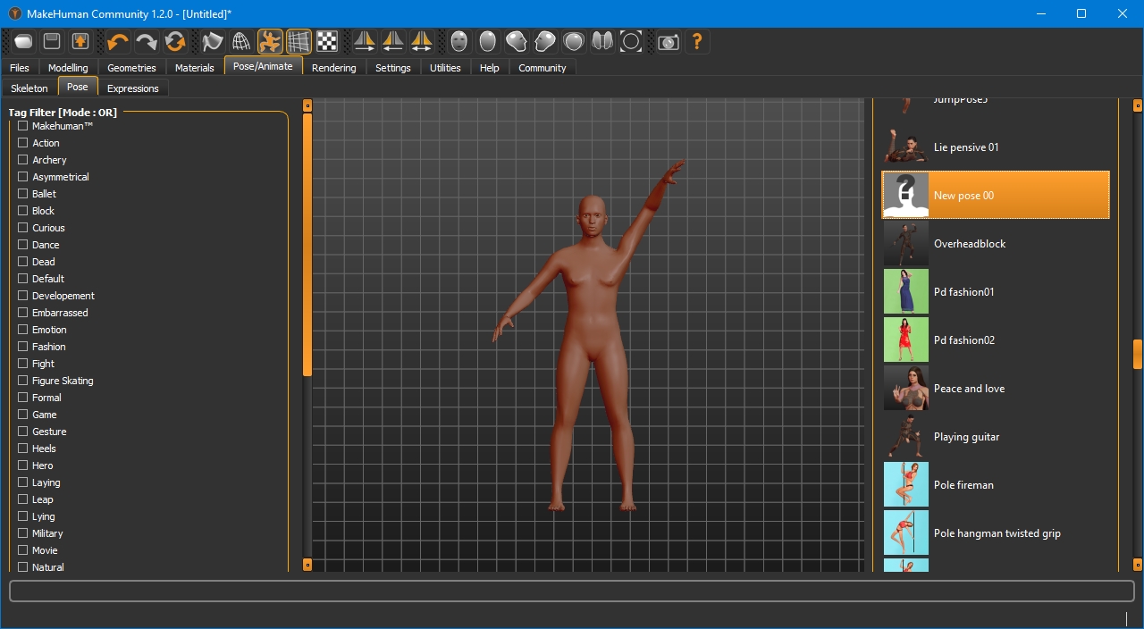

Re: Custom poses help
Postby tomcat » Sun Feb 19, 2023 12:31 pm
Twinmum wrote:
tomcat wrote:Yes, I have followed that workflow with the exception of the folder location (I don't have a v-1 folder) And yes, I am sure that I selected a default rig - I tries a couple of times with both the default rigs
I tested and did everything according to the instructions. I did it:
Posts: 336
Location: Moscow (Orcish Stan), The Aggressive Evil Empire
