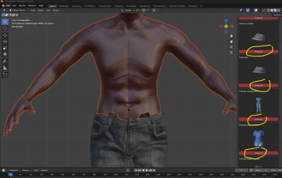

I am using MPFB, in fact, and I am wondering if that might be part of the problem. I have been using characters that were originally created in MakeHuman 1.2. As I mentioned, there was never a problem transfering them into Blender (version 3.5) on my old computer. I moved all of my files over to the new computer and everything opens up quite well in MakeHuman 1.3 and looks excellent. However, when I import them into Blender (version 4.2) using MPFB, that is when problems develop. This is an character I am working with in Makehuman. For clarity, I have made him shirtless. You can see that there is no issue along the line of his trousers. However, after bringing him into Blender, there are visible gaps along this edge and also some inexplicable holes in his belly (and, though not visible here, also in the small of his back):
Image in MakeHuman 1.3
Same Character once loaded into Blender
I have found the check boxes to prevent MPFB from overriding the MakeHuman features (notably eyes) but it seems that I cannot save these settings, and need to go back and re-uncheck the boxes each time. I guess I'd prefer if MPFB defaulted to using MakeHuman's settings when importing but, as problems go this pales in comparison to the characters showing up in Blender riddled with gaps and holes. I am no programmer, but I am wondering if MPFB is deleting whole faces out of the mesh in the delete groups, while MakeHuman perhaps was not. In any event, something is definitely going on that needs looking at.
If it is a user error on my part, feel free to make me feel like a fool, I just want to start working with these characters again. But, I don't think it is.
Regarding MPFB, I do see that it has many features that show promise. The main reason I prefer working my characters first in MakeHuman is, I suppose, largely because I am comfortable with the interface. MPFB's I find confusing. And, I do seem to have had issues with assets loading. The skins are there and usable, but everything else just shows up as inviting me to "Unequip", which I do not understand:
Other assets show only the option to Unequip
The Skins are ready and able to load

Postby tomcat » Thu Nov 21, 2024 8:46 pm
nedfarrar wrote:The skins are there and usable, but everything else just shows up as inviting me to "Unequip"
For me, the assets, except for skin and poses, just don't display.

Postby joepal » Fri Nov 22, 2024 2:56 pm
Ok, looking at the specific asset (M_Trousers_01 by MindFront), I've made some observations.
First, if importing a default character via "new human" -> "from presets" -> "import mhm", then things seem to work as expected:
However, if importing exactly the same character via "new human" -> "from makehuman" -> "import human", I get similar results as you:
The online importer (ie the second path above) is known to be a bit fragile when it comes to correctly guessing delete groups, and for certain assets it will go wrong. Due to the very complex logic involved with this, it is unlikely this will be fixed in the near future.
The male_muscle proxy also seems to have trouble making it through the online importer, and the delete group is erronously spread up on the stomach. I have yet to figure out why.
When using the MHM importer, the proxy does not break in the same way. On the other hand it does not seem to get any delete group at all. This is a bug, and I've opened https://github.com/makehumancommunity/mpfb2/issues/221 for this. This I'll fix asap, and I've placed in the milestone for the 2.0.6 release.
Anyway, my first suggestion for improving the situation on your side would be to use the MHM path (which is the recommended approach these days) rather than the online import. This should also allow you to equip and unequip clothes inside blender.

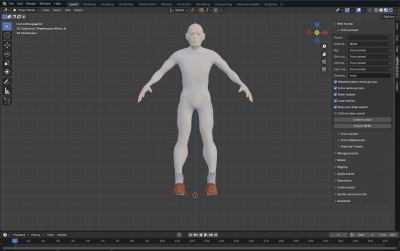

Oh, I was so hoping this would be as simple as it seemed in your description. Unfortunately, it has not worked out that way. I just tried to import following your suggestion of going "new Human" --> "from presets" ---> "import MHM" and Blender opened up a window for me to navigate to an MHM file. I went into MakeHuman --> vlpy3 --> models and found the character, which did then import...minus skin, eyes, clothes, everything except the rig and for some reason — shoes. He was wearing shoes:
Imported Figure
Once imported, I was able to give him skin and clothes through MPFB — hurrah! — though the selection is more limited that I had through MakeHuman, and there seem to be poses in MPFB, but no expressions (did I miss those somehow?), and ... at the risk of becoming unpopular with the design team, I still find MPFB's interface confusing and somewhat clumsy as compared with MakeHuman's. It also lacks many of the assets/materials/topologies, etc. that I have been using in MakeHuman plus the aforementioned expressions (which I expect i will eventually discover are missing because I somehow overlooked them during set up)

Postby joepal » Sun Nov 24, 2024 1:18 pm
You do not need to wait for the final release to get the fixes. They will be available in the nightly builds as an when they have been implemented. I've pushed a fix for the missing delete group on the proxy now, so that will appear in tomorrow's nightly build.
For the rest of the issues, I suspect parts of it are a question about proper documentation. For this, I've added https://github.com/makehumancommunity/mpfb2/issues/223
I'm going to spend some time documenting the configuration and import paths. Once that has been done, I will be interested in hearing which problems remain.
