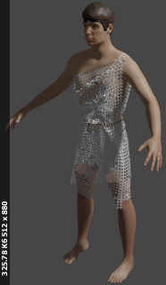

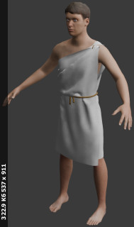

Skalldyrssuppe wrote:it turns out its a problem with the male_chitton clothing
There is a problem with clothing, indeed there is… but that doesn't prevent imports:
I fixed a similar thing, but I don't remember how.
You can use import to Blender via socket or MPFB2 (it allows you to import models from MakeHuman).
