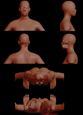

I have encountered a problem that has been around since MH v1.2.0 concerning rendering. Below is a resized GIMP mosaic of six images taken from different angles on the default base model and rendered with standard default settings. The only enhancements are subdivisions and symmetry enabled on the main toolbar.
Rendering error in MH v1.3.0
This issue is of note because it cropped up and was fixed in 1.2.0 via driver updates from nVidia on my main 'station. The problem persisted on my Apple iMACs. I never tested it in Windows since I run W7 on my production boxen.
However, in v1.3.0 the issue has reappeared and is persistent on all my Linux Mint Cinnamon Virginia (Jammy) machines, including an Apple iMAC that has been reloaded with Linux Mint. I have also tried it on Linux machines with the standard Intel PCH setup and it is evedent there as well. Thus, I am thinking this is not an nVidia driver issue.
The really interesting thing about this error is this: when the advanced rendering function is enabled with the lightmap turned on, the render is as it should be, without the error. This has baffled me no end since I lack the deep knowledge needed to dive in and find a solution.

I had hopes that this newer driver would resolve the issue described above but it did not. The problem still persists. Basic rendering has mouth and eye cavities visible. As before, if advanced rendering is enabled and the lightmap box is checked, the render is OK. This only happens on MH v1.3.0 .
I am still at a loss as to why this is happening because I can duplicate the error on any machine running the Jammy fork. The Focal fork running MH v1.2.0 does not have the issue, even with the newer 535 driver. It is the same driver that the Jammy fork uses.

Ricardo2020 wrote:NVidia released an incremental update to the 535 driver for Linux Mint on the date of this posting.
On Win 11 (NV Quadro RTX) exactly the same situation.

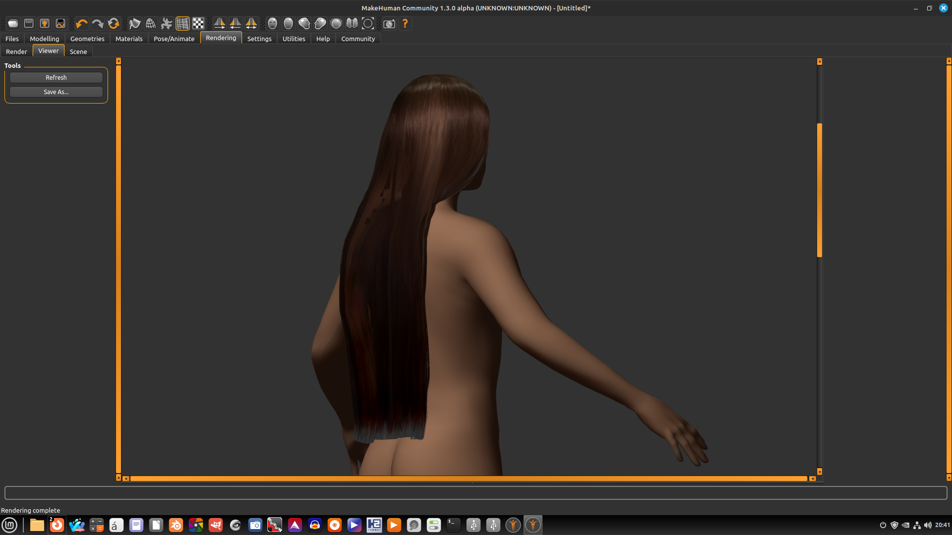

I noticed that, when in Advanced Render with Lightmap checked, I no longer see the body cavities but I did notice that the transparent ends of the long hair are not transparent, they are gray, as seen in the screenshot below:
v1.3.0 advanced render with lightmap
One needs to look close at the hair ends. See all the opaque gray which should be transparent? It is as if the issue is reversed in the two render modes. In basic, things are transparent that should not be, and in advanced with lightmap, things that should be transparent are opaque. If I disable the lightmap, it acts the same as the basic mode with body cavities showing. Why is this happening?

My take on this is that it is yet another indication that the old code base needs to be replaced with a modern version (ie the one that PunkDuck is working on). The now close to two decades old 3d engine in MakeHuman builds on an OpenGL version which is beyond ancient and only randomly supported by graphics cards.
I very much doubt there will be a fix for the 1.3.x or 1.2.x code bases which would a) be within reach, b) improve things significantly and c) not break about as much for a lot of users. The main issue here is "a". The only way to fix the core 3d issues would be to rewrite large parts of the underlying 3d logic from scratch, which is a huge undertaking.

Looking at the OpenGL problem, I think you have hit the nail square on the head. New drivers are throwing spitballs at old code. This is why Tomcat and I are seeing the rendering problem. It makes perfect sense, and so there is no fix for the issue other than what you mention, to help develop the new version while diving into Blender and MPFB.
