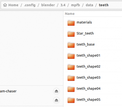

I have tried manually entering the path - and re-starting blender, checking the box for automatic discovery, and copy the contents of the data folder to ~.config/blender/3.4/mpfb/data. Restarting blender each time.

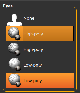

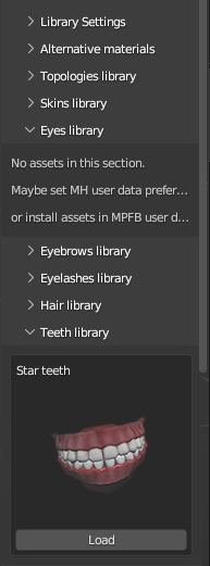

As an example, in MHC 1.2.1, for Geometries, teeth, I see 7 sets of teeth, and 2 sets of eyes, and the contents of the respective directories in data folder match. However, using MPFB in blender, for eyes, all I see is "No assets in this section. Maybe set MH user data preference or install assets in MPFB user data. For teeth, only one set is visible.
What I see in Blender using MPFB
What I see in MPFB menu
One of the things I noticed, in the case of the teeth - the set that I see in Blender - star teeth, has an obj file, while the others have mhpxy and npz files.
What am I missing - not working in Blender 3.4.1? Ubuntu 22.04? Or something completely different.

Postby OBI_Ron » Mon Feb 06, 2023 11:24 pm
Asset packs - right - forgot about the asset packs

Postby joepal » Tue Feb 07, 2023 2:08 pm
Yes, shouldn't need to manually copy system assets from MH to MPFB. I don't know about star teeth, but the rest of the teeth assets are in this pack: http://static.makehumancommunity.org/as ... ssets.html
