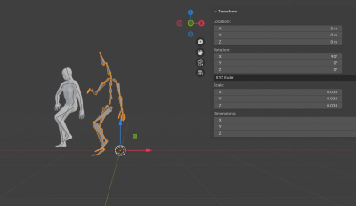

Postby InezDias » Mon Feb 24, 2025 4:45 pm
Update: Global Transform for Source Armature is now also working:

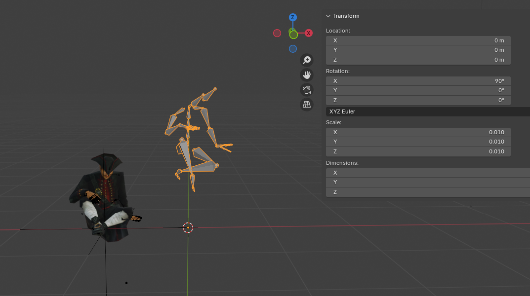

Postby InezDias » Mon Feb 24, 2025 5:37 pm
And for target armature:
Though that is a less likely situation to occur in reality, since the target is expected to be a makehuman character.
