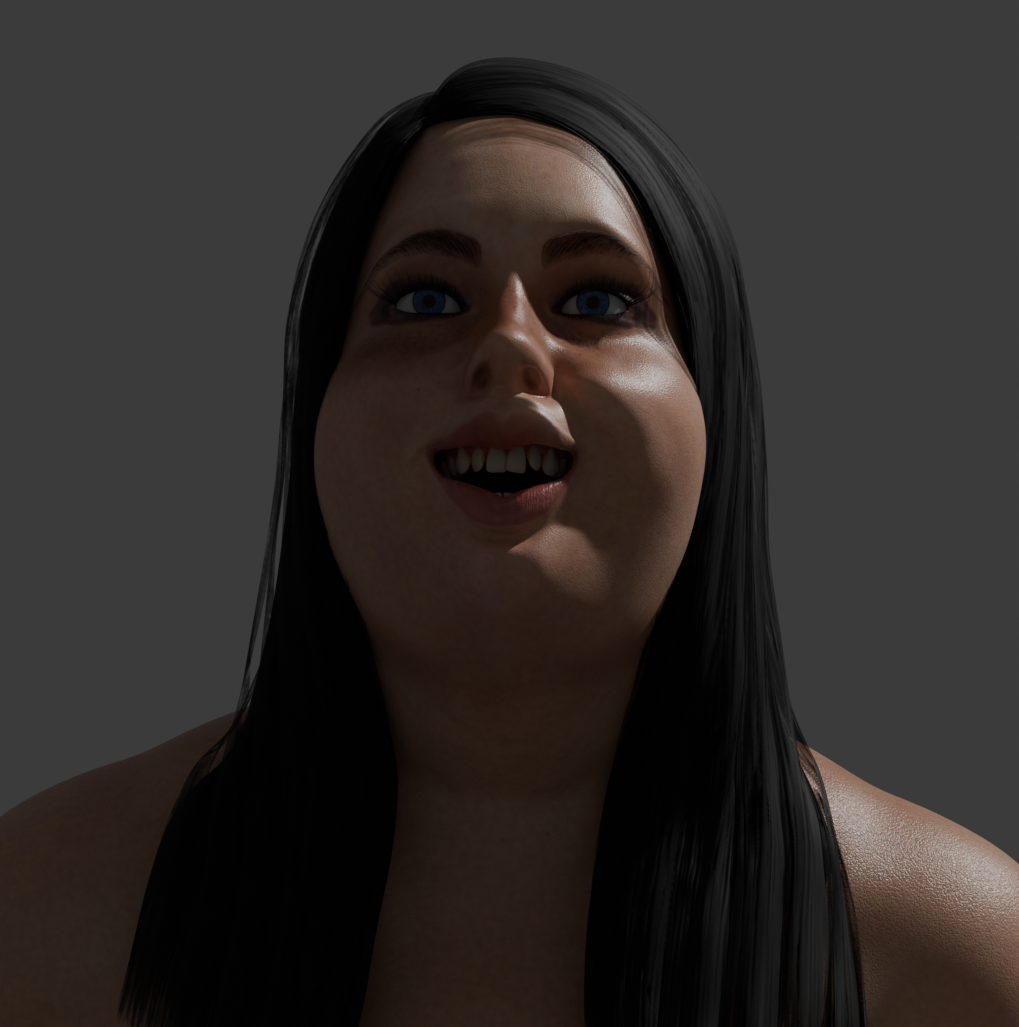

Next, a bewildered smile. The drinks are kicking in and not in a good way, but she is trying to hide those feelings with a cheeky grin. Meanwhile down around the belt line, things are beginning to slosh around...
Bewildered Smile Face

These expressions each took over fifteen minutes to make. The rolling stone face was the hardest because that tongue is a touchy item and I had to back out and start over a few times. It will twist every which way until one learns how to go slow and easy with the little rigging helper tools.
In all instances, doing this work without the rigging helpers would not be practical due to the time it would take to tweak each individual bone. The little helpers make the bones move in a logical way based on motion vectors.
