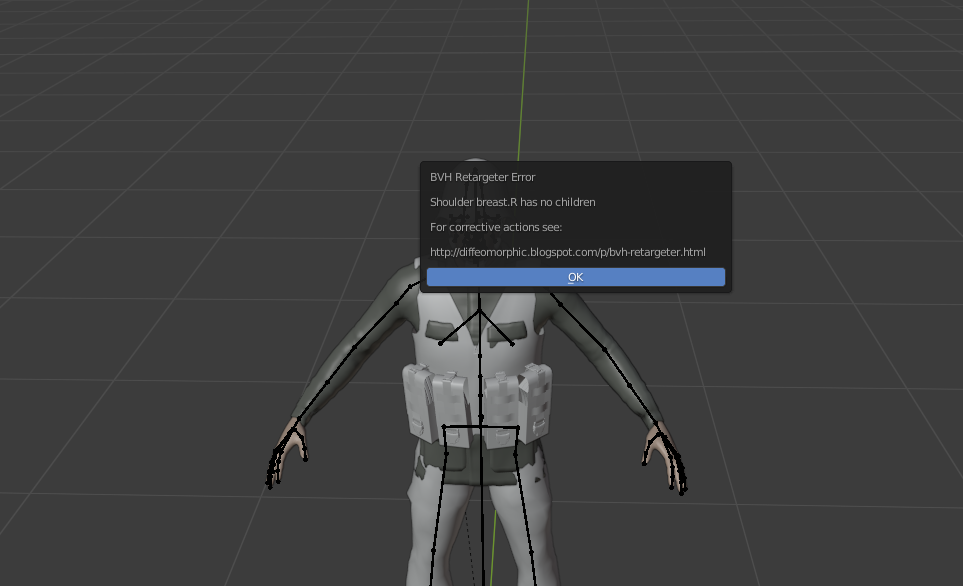

I am trying to retarget a BVH file to a Default MHX2 armature with the face rig and all that. However I get the error listed below. I am using Blender's built-in retargeter. Any ideas on how to fix this?

MrColz wrote:However I get the error listed below.
This is a BVH Retargeter error. It should be fixed in the version I mentioned:

Postby MrColz » Tue Feb 15, 2022 11:45 pm
Retarget BVH
This did the trick. Thank you.
