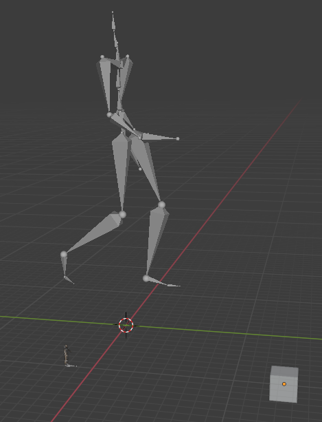

I have made some characters using makehuman and now I wanted to retarget it to a CMU .bvh file in Blender(2.93.1) through bvh retargeter add-on.
However when pressing " Load and Retarget", an error occured: " BVH retargeter can not use this rig because it has: object rotation, object scaling, apply object transformation before using BVH retargeter", I have also tried "Ctr A" to apply the transformation, still the same error occured.
The CMU .bvh file is shown in the attachment(bvh was not allowed as the attachement and I uploaded a screenshot pic) and it's indeed ten times taller(has a height 10 meters) than makehuman, Could you tell me how to transform this bvh file or how to solve this retarget problem?
Thanks a lot.

makehuman987 wrote:The CMU .bvh file is shown in the attachment
Could you put the .bvh on a file exchange site and post the link here?

OK, the bvh is attached with blend as .rar file. What's more, I used makewalk instead of bvh retargeter, this error disappeared, but the action was weird. The original motion is walking forward, while after retargeting, the motion became climbing.

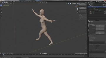

Postby makehuman987 » Tue Dec 21, 2021 6:03 am
Dear woodcat:
thanks a lot.
The bvh file is downloaded from this website: http://sites.google.com/a/cgspeed.com/c ... on-capture . It's also from CMU.
As for the skeleton, I chose the makehuman 'Game engine' which has 53 joints and different from CMU skeleton. Today I also tried makehuman 'CMU mb' skeleton but still the animation is not right, just as the attached pic shows, the character stoop down.
Moreover, I tried the ACCAD bvh file(http://accad.osu.edu/research/mocap/mocap_data.htm), after retargeting, the character also stoop down.
Seems rig or something is not right . Anything needs to be set in the addon makewalk or bvh retargeter? Or is there any other retrageting add-on or any other way of retargeting?

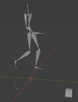

Re: Animation retargeter problem
Postby makehuman987 » Wed Dec 22, 2021 2:44 am
hi, woodcat
I downloaded bvh file from the link you supplied and tried in blender, however the movement is weird. The character walked forward with arms and legs crossing, just as your pic showed.
