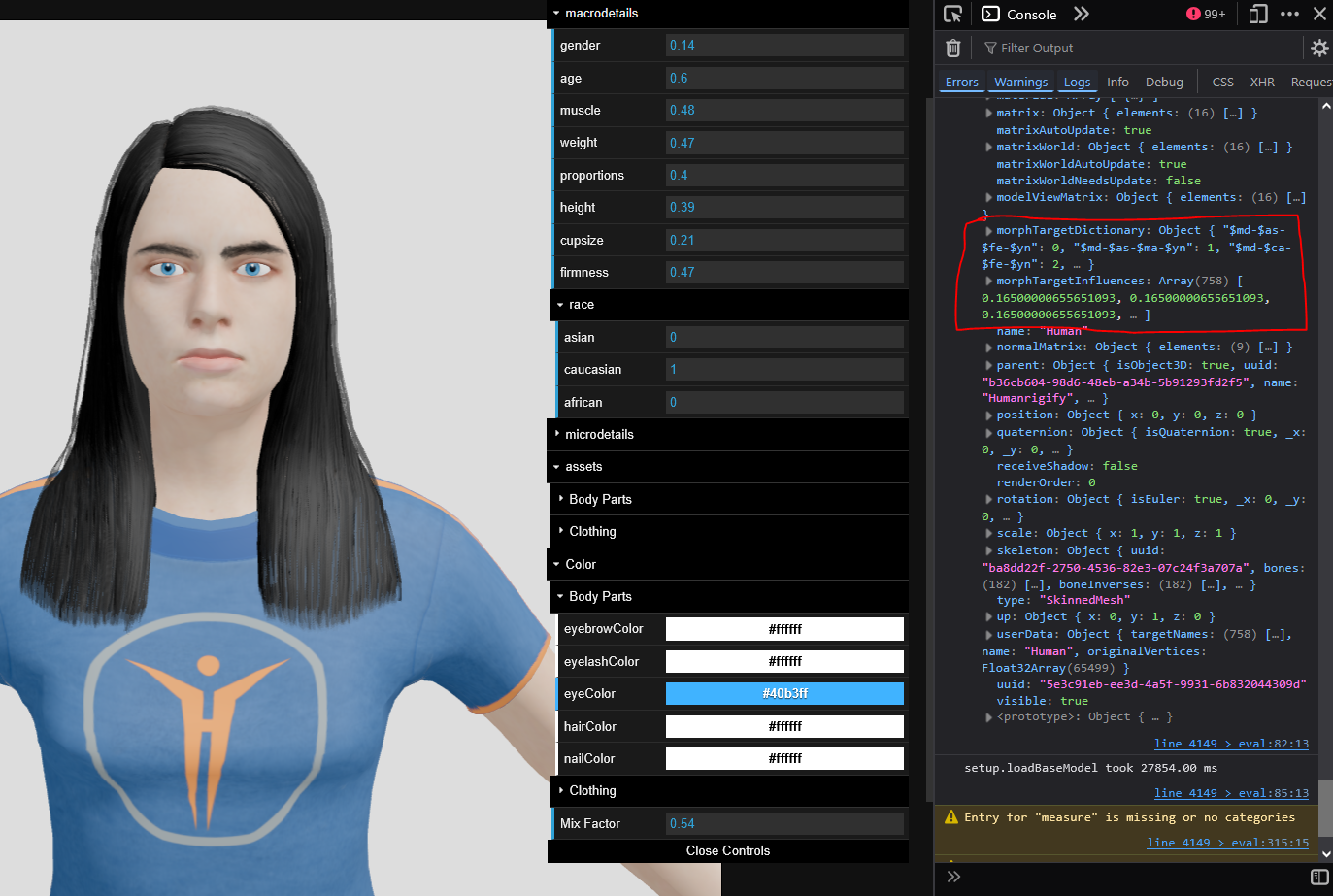

hi, i was able to export a model with 758 shape keys from blender in glb format. it is 125 mb, and takes around 25 seconds to load into the browser (i have no idea whether these numbers are good or bad btw lol). i think joepal's suggestion of loading them dynamically is the best approach, but the way i did it was similar to tomcat's.
when you adjust the macrodetails in blender, it adds relevant shape keys automatically, which can be seen on object data properties. it is important that you should uncheck the "prune" option in mpfb settings, because it removes shape keys with no effect on the model. then, just set one category to 0 (gender for example), and move all other sliders between 0 and 1. this will add all possible female shape keys like "female-young", "female-old" etc. then you move gender slider to 1 for male, and repeat. then move to next category and repeat. it's time consuming but i guess it can be done through a python script in blender.
shape keys and their influences are located at your model's morphTargetDictionary and morphTargetInfluences properties.
