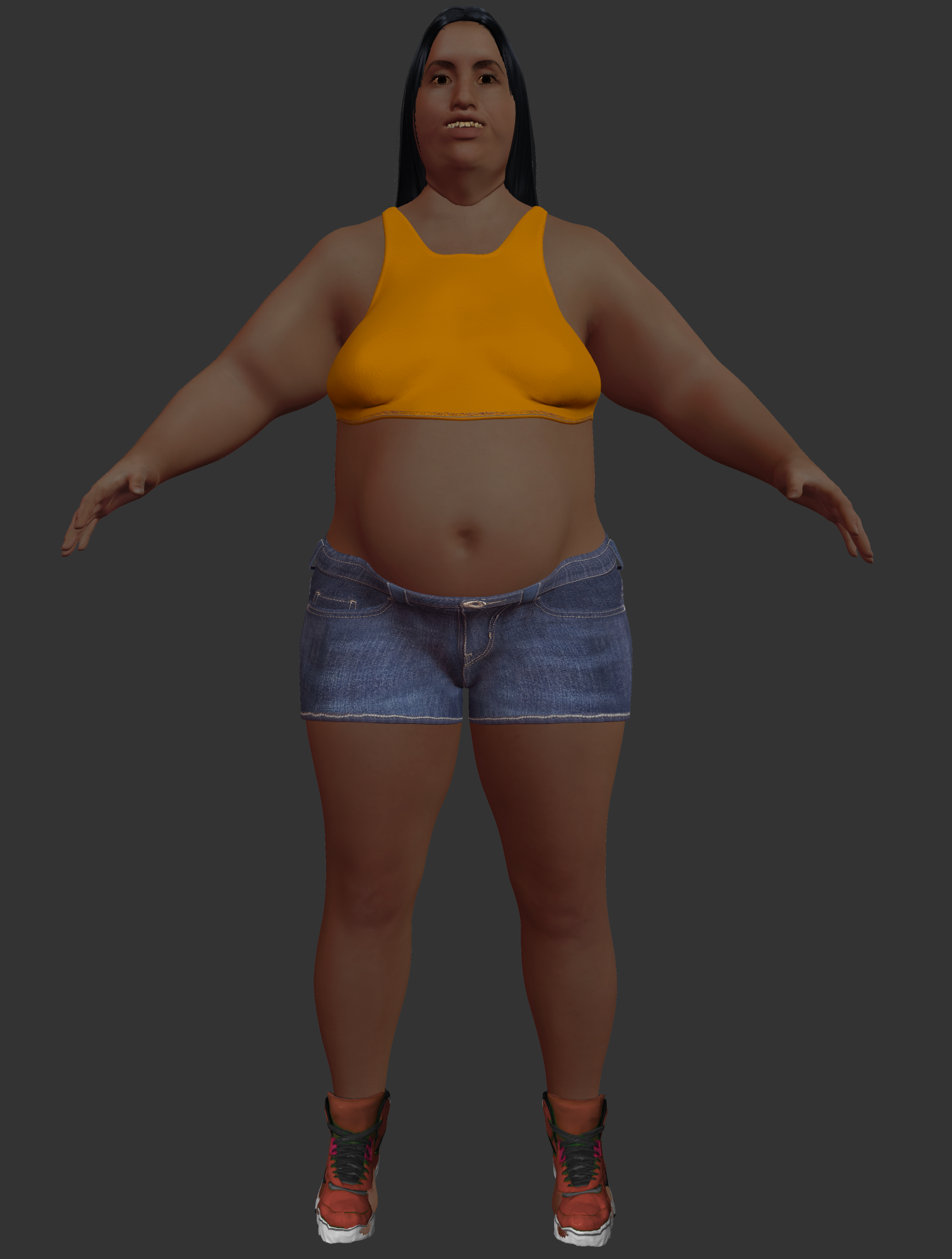

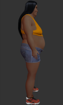

Postby Ricardo2020 » Fri Sep 10, 2021 3:14 pm
Eva Gomez, Phillipines
lucha cholita (female wrestler)

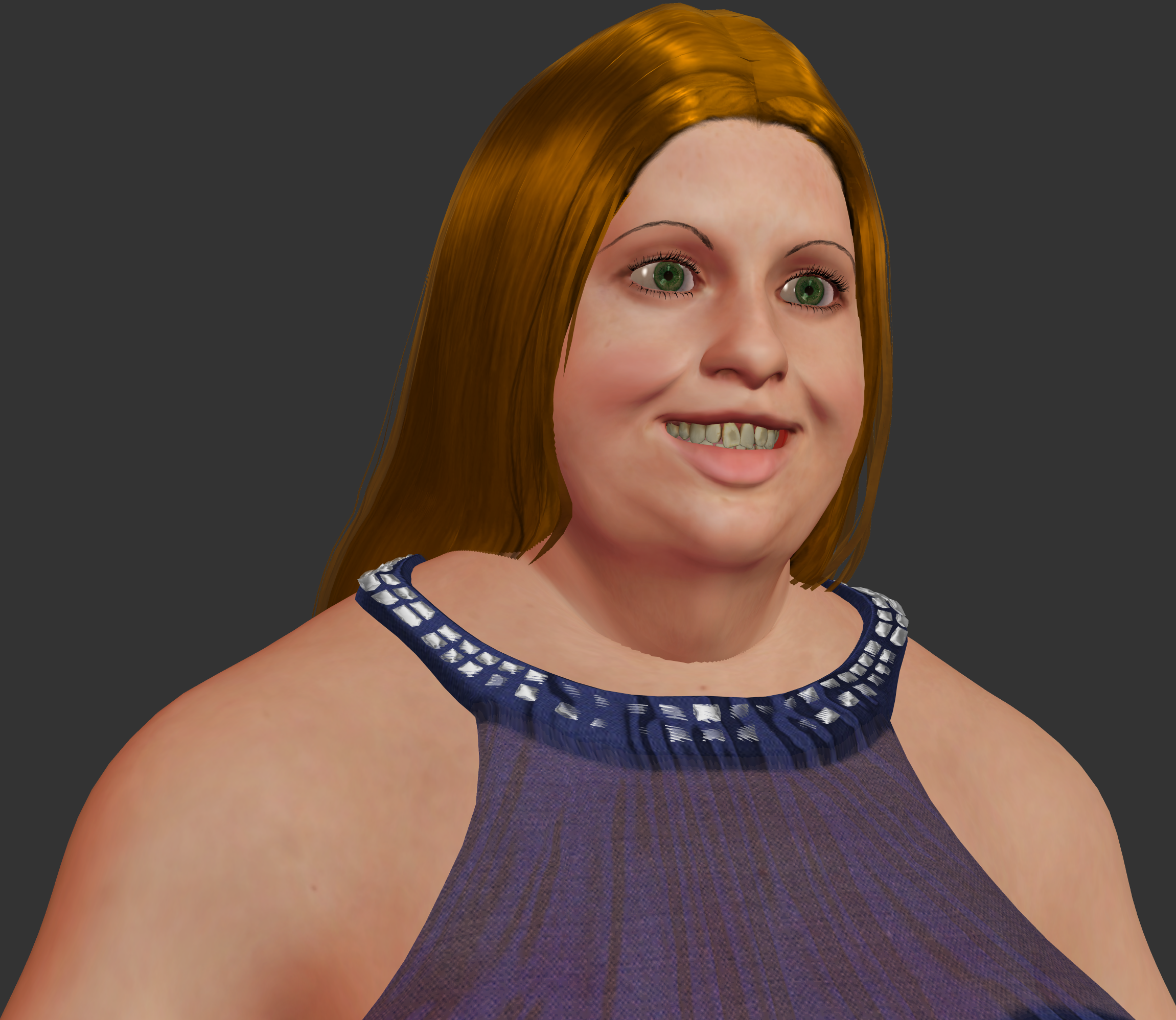

Postby Ricardo2020 » Sun Sep 12, 2021 3:37 pm
Aja Singh, India
Hired Mercenary

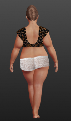

Firstly, ty for all your kind words! Secondly, a great deal of what irks you is simply not that fixable makehuman side, and in fact benefits from multiple types of overlaying remedies. For instance, having polygon hair move with the body in a more natural way is simply not the nature of that particular beast! Then using particle hair might be the route to natural appearance blender side going forward, alternatively editing or making new polygon hair for every pose? In regards to body tissue moving more naturally, I have found success in past, in places such as opensim using jiggle rigs. Having different bones in a skeleton representing body parts that will move such as breast and butt areas. I have personally seen much success with this even with body parts one might not suspect. Makehuman offers no physics or other gravity based effects yet to date to my knowledge, and blender would be the way to go to get to that place with tweaking and use of modifier stacks.
All of that said, I have a plus size model, miss Cheryl Lyn-not very large but plus size nevertheless, and thus I have worked out a handful of targets to bring her weight to a larger more natural place(to my eye). Now I have not used any of the existing big lady model targets in the repository personally. And none are used in Cheryls images. I have created a few targets I would like you to go over and test for me if you will, I will upload here in zip for beta purposes. Feel free to give feedback here, or in message form if you like. As I have absolutely no experience with heavy target making, they may not be the best, but I have done my level to be respectful to the female form and output something befitting.
Cheryl Lyn is using only these targets and my wattle jowl, and I will show you my humble works here to give reference. Images from makehuman not blender.
:D
Elv
bigladytargets1.zip
31 unique targets for heavy lady project
(49.91 KiB) Downloaded 126 times
makehuman screenshot

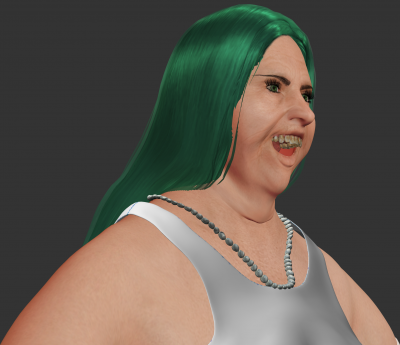

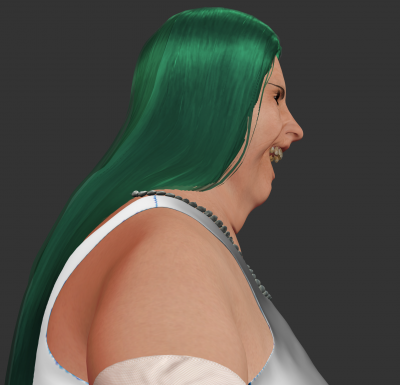

Postby Ricardo2020 » Tue Sep 14, 2021 4:26 am
Using targets to shape a BBW chin
Screenshot from main workstation
Good evening, Ma'am.
Every target in the kit works well. I am still learning how each one affects the others. I am also working on the interactions between these new targets and the ones already in the repo. The chin is really tricky. At first, the mesh tore around the head/neck juncture, but I was able to fudge it around to fix the ripping. In the image accompanying this reply, look closely at the area mentioned where the head and neck come together and note the little valley below the chin near the neck.
This area is sometimes exactly like one sees, with the little crease. Other ladies will lack this crease completely or have it in various amounts from a well defined seem to none at all, AKA, the "neckless gal" shape common to clinically obese patients. Using all available targets and a lot of tweaking, I was able to get this far. Note the dent right under the chin just behind the point where it sticks out below the mouth. I could not make that go away, but I am still working with it.
To be truthful, this is the most realistic looking BBW face I have made so far, and your targets make it possible. I must also add that the body targets, especially those that create the spare tires and apron, do a wonderful job on the belly. Know that the belly is always a challenge because we have a lot of sliders that all interact. It is a lot like torquing down the screws on a CPU heatsink. You have to take them all down together in a star pattern, until all are bottomed out.
Targets will always affect other targets, some more than others depending on the strength and vector of the target in question. With the chin, we have sliders found in the neck, chin and cheek areas which definitely interact. When we turn on the jowl and wattle, things really get interesting. The biggest interplay is with these sliders and the double neck control in conjunction with measure/neck/diameter and face/neck/scaling. The head and neck movers also make big changes with a small push.
So, it is not enough to have the sliders, but also, to know how they work together to achieve the desired result. With your new controls, I can come much closer to the real thing, and with more practice, probably arrive there (or get close enough for government work.) As I play around with these sliders, I am bound to find the combinations which work the best. Perhaps then, I can show the world how I did it. When that time comes, I will tell them that your work made it all happen.
