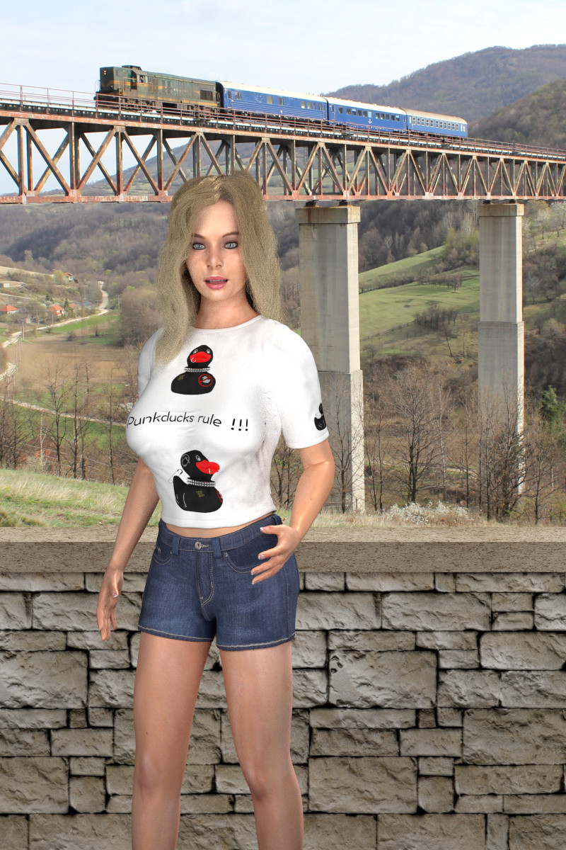

Meanwhile I created a civilian version of DredNicholson's camouflage T-Shirt. I made small changes for my own version (I lowered the t-shirt a bit, so that it does not levitate above the shoulder). You can download the material and create your own logo or whatever you need.
On my picture Dani is staying in front of Kriveljski railway bridge in east-Serbia. Definitely a place where you better wear non-camouflage clothes ;)

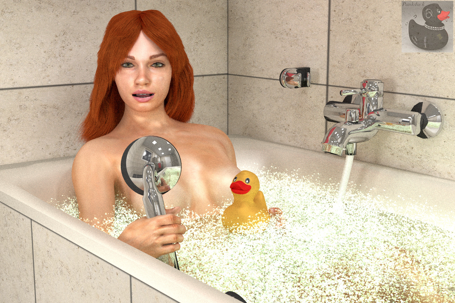

The only thing my girls now can do, is to show some CLEAN nudity (in the truest sense of the word), after giving nearly all my clothes to MakeHuman community there is a severe lack of clothes at home :lol:
As you also might recognize: In front of leska the civil relative of punkduck takes a bath ... :mrgreen:
I tried a lot versions of foam and ended up in a particle system with zero gravity. In some way it looks like foam. And for wet hair, I've also no solution until now :oops:
Posts: 1216
Postby DredNicolson » Wed Nov 23, 2016 1:53 pm
A starting point is thinking about how water affects hair. Wet hair is darker and heavier, and it adheres to the skin. The ends of individual strands get "glued" together into spikes. The water forces out air and removes any puffiness, and its specular properties mix in with those of the hair, changing the reflections.
So most of the particle strands need to be straight, puff-less, and clumped into spikes at the ends. The remainder should be twisting and sticking to various parts of the face--forehead, cheeks, neck, and so. Edit the material to have darker diffuse color and mix in a water-like specular shader into the original hair spec.
