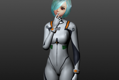

And worth mentioning, even though it is not anime per se, is sontg78's community target to "toonify heads", named aptly enough, toonify14. This slider in conjunction various other sliders may be quite useful for creating base shapes that can be morphed and developed into true anime in a downstream application. Take a look at modeling measure as well as the more standard sliders if you decide to try this route.
Developing a series of anime-oriented targets with proper anime proportions might be a group-task that an interested set of anime artists could pursue together. [asymmetric tunic top on image by DredNicolson] The single target approach of Oscalon may ultimately limit flexibility depending what the end-goal is.
