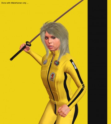

Funny enough for the smooth hairdos it works fine without the V-method. On the next picture is your long hair in a first test using only MakeHuman and the identical(!) hair textures ... of the curly hair.
It looks really cool now, I just started to sing along this text: https://www.youtube.com/watch?v=_CnXeIepbfw :mrgreen:
(the original band from the film btw.)
I'm really impressed. Upload will be tomorrow, I guess, I have to do the test-renders etc. :D

punkduck wrote:The V-method I saw first in a tutorial also used for petals, flowers etc. So this is no rocket science ;)
Oh that does look really good, yes the smooth hair models always seemed to work better till a certain length - but now i have to try the V form :)
