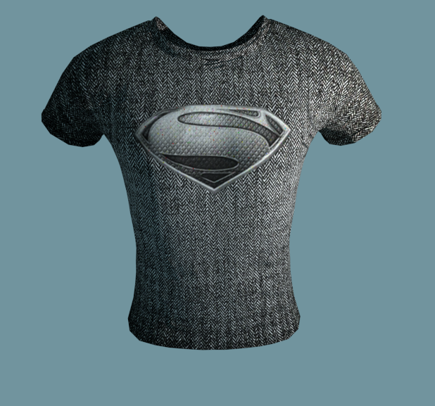

My first attempt at makeclothes, thus i went with a simple t shirt.
I am not sure if the texture actually exported, thus i have included it in the zip folder along with a Normal and AO map.
Posting it here and not under user contributions as its nothing special and i plan on creating better stuff that i will upload to there.
CLOTHES HAVE BEEN MOVED TO USER CONTRIBUTIONS

Postby duststorm » Mon Jan 11, 2016 4:37 pm
Indeed the material file does not reference the textures.
A quick tip: if you enable the material editor plugin in makehuman, and restart, you can modify the material from there.
To fix the material, add the following lines at the bottom (to the .mhmat file):
