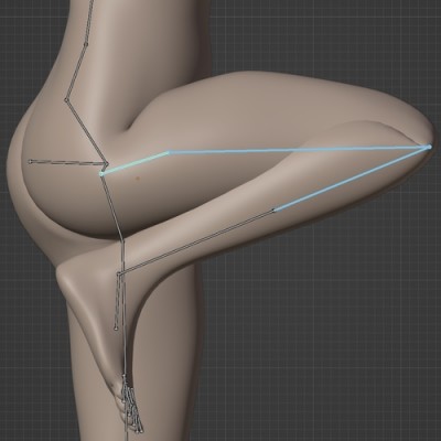

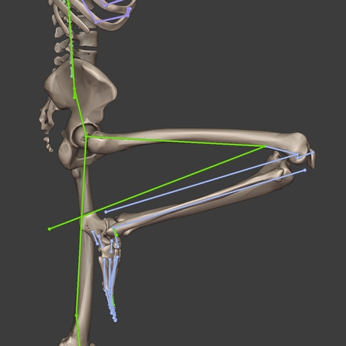

Some reflections on ancient problems. That the poses and movements of the characters would be more natural. The idea was this.
1. Rig should take into account the size of the joint (bone thickness). A similar thing is done in Z-Anatomy. BIOMECHANICS.
Here is the MakeHuman rig:
And this is the rig of an anatomically correct skeleton:
My suggestion is to add bones that would compensate for the size of the joints:
  • Rig MakeHuman
  • Rig with joint compensation
For a correct rig, you need to consider the size of all the joints. For a light (gaming) one, I think the elbow, hip and knee joints would be enough.

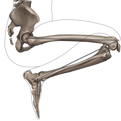

biomechanical skeleton
Hard to imagine seeing this anytime soon. I was always hoping somebody would make something in Blender similar to 3Dmax' Bipeds with physical correct bone restrictions but there really seem to be larger issues making that unlikely.

Well, it's already done in Z-Anatomy - BIOMECHANICS (link at bottom of page): proper bones and constraints. The problem is to make children's skeletons, for growing characters.
